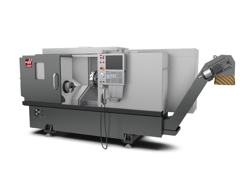

The ST-15LY is a Y-axis long-bed lathe that provides double the Z-axis travel and turning length of the standard ST-15Y for machining longer parts, while maintaining superior cutting performance, and a compact footprint. The addition of Y-axis and live tooling allows milling, drilling, and tapping on the face of the part and around the circumference for increased machine capabilities. It offers a wide selection of productivity-enhancing options and more features and value than ever before.
  • Extra-small footprint
  • BMT45 turret
  • Big-bore spindle
  • High rpm and rapid speeds
  • Extended Z-axis travel for machining longer parts
  • Standard manual hydraulic with a hydraulic quill
  • Extended tool pocket in the bulkhead provides clearance for long tools
Lathe Auto Parts Loader for Haas CNC Y-axis long-bed lathe
The Haas Automatic Parts Loader is a simple and affordable way to automate part production and boost productivity on Haas CNC turning centres. It is designed and built exclusively for use on Haas turning centres, and connects directly to the Haas control.
CNC Lathe w/Y Axis; 12″ x 32.5″ (305 x 826 mm) max capacity, 2.5″ (63.5 mm) bar, 16.5″ (419 mm) swing, ±2.00″ (±50.8 mm) Y-axis travel, 20 hp (14.9 kW) vector drive, 4000 rpm, A2-6 spindle, 8.3″ (210 mm) chuck, 12-station BMT45 turret, high-torque live tooling w/C axis, 15″ colour LCD monitor, memory lock keyswitch, spindle orientation, USB port and rigid tapping. Standard toolholder kit included.
