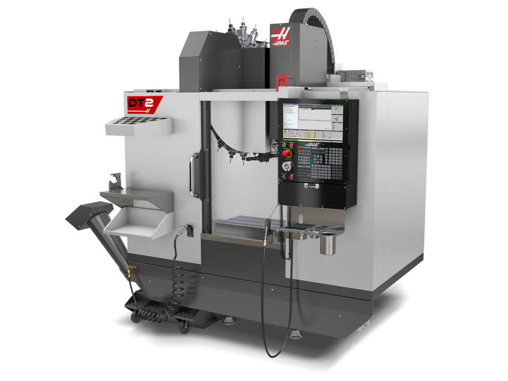

The DT-2 is a compact, high-speed drill and tap machine with full milling capabilities. A powerful BT30 taper inline direct-drive spindle provides 10,000 rpm, and allows high-speed rigid tapping. A high-speed, 20-pocket tool changer swaps tools quickly, while 2400 ipm rapids and high acceleration rates shorten cycle times and reduce non-cutting time.
The DT-2 offers the same lean-style performance and benefits as the DT-1, while providing more X-axis travel and a longer table to handle larger work.
- More X-axis travel and longer table than the DT-1
- Powerful BT30 taper inline direct-drive spindle
- High-productivity machining center with a compact footprint
Drill/Tap Centre; 711 x 406 x 394 mm, BT30 taper, 15 hp vector drive, 10,000 rpm (12K, 15K & 20k opt.), 61 m/min rapids, high-speed 20+1 side-mount tool changer, power-failure detection module, 1 GB program memory, 15″ colour LCD monitor, USB port, Ethernet interface, memory lock keyswitch, rigid tapping and 170 L flood-coolant system. Anchor kit highly recommended for installation.
