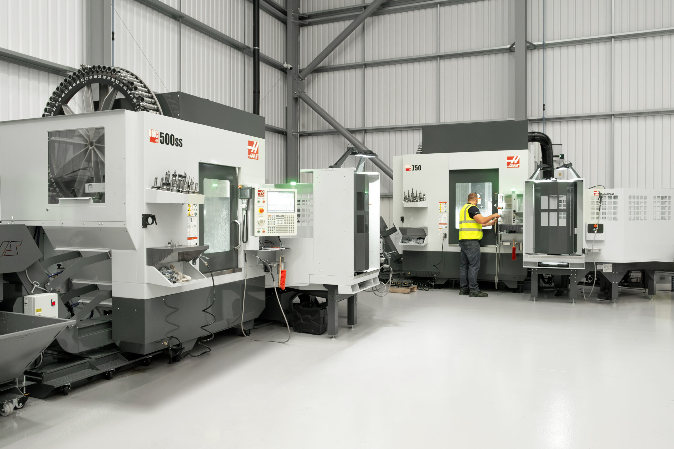

Opus began with a single Haas 3-axis machine but demand from its customers meant it soon had to increase capacity and capability. The company now has seven Haas machines on its shopfloor: a VF-2SS vertical mill, a VF-6, two 5-axis UMC-750s, a DS-30Y twin spindle Y-axis lathe and two 5-axis machining centres with Haas’ Pallet Pool automated loading systems, a UMC-500SS with a 70 tool carousel, and another UMC-750.
According to Mr Siddall the introduction of the Pallet Pool systems has had significant benefits for Opus including a move to much longer periods of lights-out production.
“It has totally transformed our workflow,” he enthuses. “Demand was increasing and I was having to come in at weekends, so we needed an automated solution to keep up. With the Pallet Pool we can schedule shorter jobs during the day and longer ones with higher torque demand, like cutting steel, in the evening when energy costs are lower.
“It also means we can run non-stop over an entire weekend. On a Friday afternoon our operators fill the Pallet Pool with the selected jobs and return on Monday to find they have been completed or are sometimes still being machined. Essentially it means that jobs that would have taken an entire working week can be done in two days.
“Additionally, because the Pallet Pool is completely integrated with the Haas control, it’s very easy to set up. You can select a programme with a touch of a few buttons and press start; there’s no complicated robotic programming.”
A camera system on the machines also ensures spindles keep turning. If a tool breaks or becomes worn, the Pallet Pool automatically moves on to the next job that does not require that tooling.
